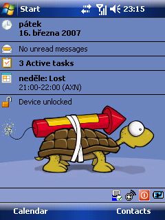

[23:15] Pridavam screenshot today obrazovky, WM6 je vskutku libiva zalezitost, nevidim duvod instalovat Wis Bar.

- prophet-wm6today.jpg (20.07 KiB) Viewed 7009 times
